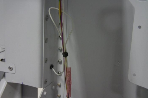

RH Side Installation

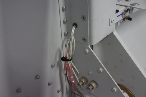

RH Side Wire Splice
RH Side Wire Splice
LH Side Wire Splices
