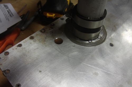

Fuel Tank Vent Mod Holes
Removal of res sender plate already done as part of SB13-12-19. (step 1)
Using template, drilled vent hole in top tank skin. Deburred hole. (step 2).

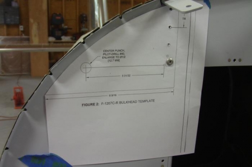

Using template, drill vent hole in baggage bulkhead. Deburred hole. (step 4).
Installation of res sender plate will be done as part of SB13-12-19. (step 5)
Vent Hole in Tank Top Skin
Template for Baggage Bulkhead Hole
Baggage Bulkhead Vent Hole
