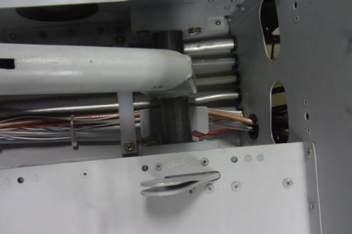

Dressed wiring and installed system blocks. As part of installation of the first two system blocks, installed/adjusted wire cover plate. (step 4 finish)

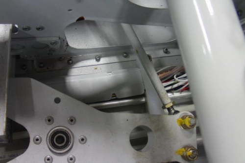

Page 53-11
Installed flap handle/pushrod assembly and secured to seat ribs. During installation, installed wire routing bracket on left side to hold wires/tubes away from the rotating part of the flap handle. Installed flaperon pushrods and flap detent bracket in accordance with KAI section 32. (steps 2 and 3). Verified that full range of motion can be made without any binding or catching on wires or tubing. As part of update to Section 32, plans allow flap detent bracket ramps to be cut so that was also accomplished. After installation, the ramps are OK but a slight button push is required before riding the ramp up to the next detent. For now, I think I'll go with that and see how it works once flying.
Step 4 is NA since those items were never removed becuase they have not been installed yet as part of the build.
PAGE 53-11 IS COMPLETE
Wire Cover Plate
Wire Cover Plate
Wire Routing Bracket
Flaperon Pushrods Installed
