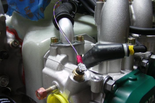

Routed left and right CHT wires to sensor, crimped connector to wire and attached to sensor post. (steps 6 and 7)

LH CHT Sensor
LH CHT Sensor
