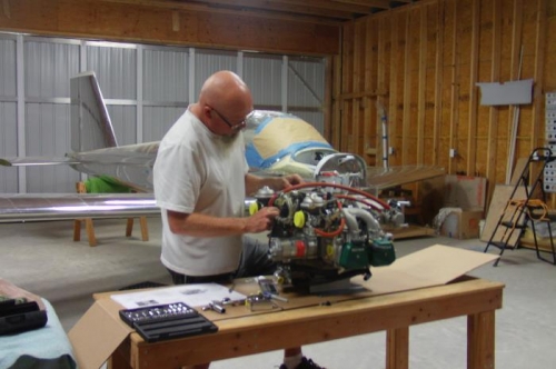

Borrowed an engine hoist but ultimately did not use it to move the engine from the crate to the work table. Neighbor Quinn helped unbolt the engine from the crate and lift it to the work table.

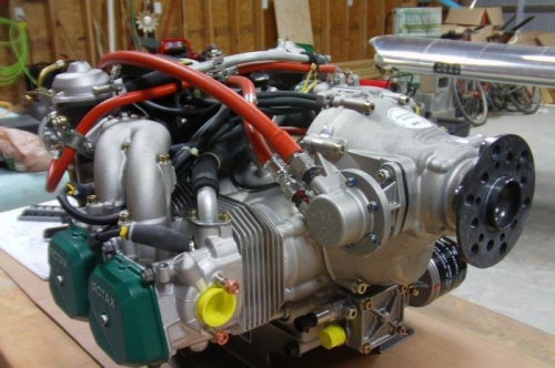

Re-clocked water inlet water elbow from 10 o'clock position to 4 o'clock position shown in the KAI. Torqued bolts to 90 inch-pounds per the IPC. (step 2)
Marked ignition electrical connectors, removed from brackets, and disconnected . (steps 3 through 6)
Disconnected spark plug leads and pulled lower wires up as far as possible. (step 7)
Removed two cushioned clamps and spacer from inboard crank trigger coil. (step 8)

Engine on Work Table

Top of Engine Exposed
