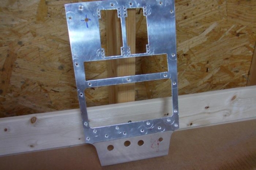

Machine countersunk attach screw holes for center panel. (step 1). Also, drilled 1/2" autopilot disconnect switch hole.
Page 42M-05
Drilled 1/4" hole in center panel for dimmer. (step 3)

Center Panel Drilled & Countersunk
