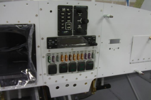

Checked fit of the radio with the cutout in the center panel. Slit snap bushings and installed into com support brackets. Temporarily installed switch panel to center panel and installed center panel to stack angles. (steps 4, 5, 6, and 7).
PAGE 42G-02 IS COMPLETE
Page 42G-03
Installed GTR200 tray, Actually did the install concurrent with the ADS-B brackets installed onn page 53-05. Routed wire harness and connected to AV-5000A control module. Connected com antenna to the radio. Installed radio into tthe tray. (steps 1 through 4).
PAGE 42G-03 IS COMPLETE
Radio Installed
Radio Installed
