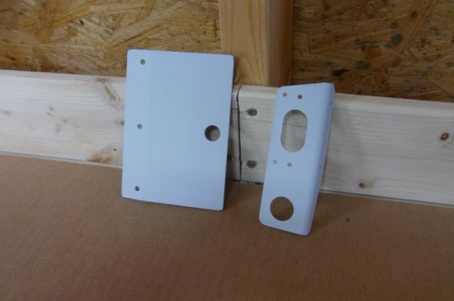

Brief Description:  Prepped ELT Angle & Bracket
Determined that the ELT angle previously installed will need to be replaced with the F-12122 ELT angle provided in the avionics kit.
Deburred ELT angle and F-1205G ELT bracket. Scuffed parts with Scotch Brite pad, cleaned with Acetone, and primed with Stewart Systems Ekoprime
Deburred & Scuffed
Deburred & Scuffed
Cleaned & Primed
Cleaned & Primed
