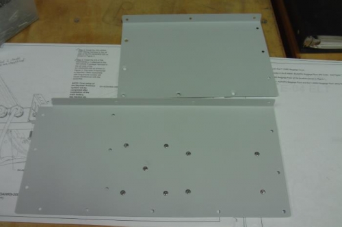

Brief Description:  Prep Baggage Floor Covers
Old baggage cover was already removed and discarded as part of mouse damage repair. Dimpled #19 specified holes in baggage floor cover that sits under fuel tank. Scuffed covers with Scotch Brite pad, cleaned with Acetone, and primed with Stewart Systems Ekoprime. Installed rivets in empty holes in ADAHRS baggage floor cover. (steps 1 through 3)
Covers Prepped
Covers Prepped
