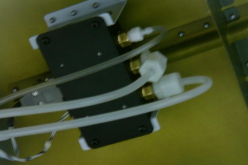

Brief Description:  Finalized AOA Tubing Install in Tailcone
AOA tubing followed the same routing as the ADS-B coax, then followed the wiring along the F-1208 fuselage frame to the top. Installed Acetal Barbed Tube Fitting (straight for 1/8" Tube ID X 1/8 Male Pipe Size - McMaster Carr PN 5047K14) into ADAHRS, then slide tube onto barb.
AOA Tube (LH port) in ADAHRS
