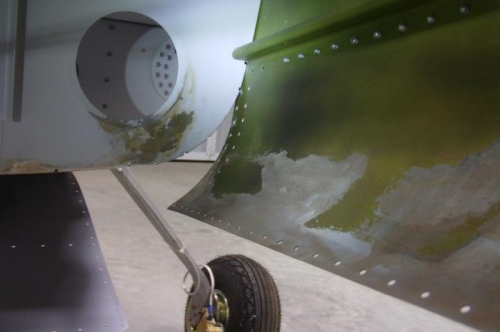

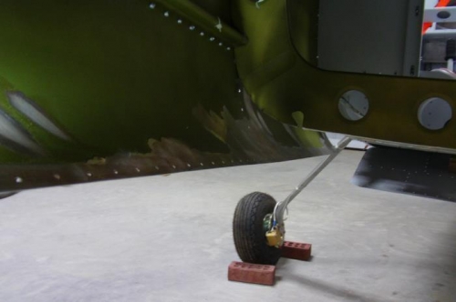

Brief Description:  Cleaned & Treated Tailcone
This entry covers scattered days over the past 10+ days. More family business to attend to.

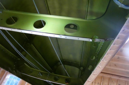

Cleaned F-1281-L and -R lower skins and frame assemblies. Cleaning accomplished by rubbing affected areas with rags soaked in Acetone to remove primer. Most stuff came up but did have to scrub corrosion areas with Scotch Brite pad soaked in Acetone. Some minor pitting but not too bad.
Cleaned all affected areas with Alumiprep and rinsed with distilled water. After drying, used Bonderite M-CR 1132 Alodine pen on all areas with exposed aluminum and allowed to dry.
RH Side

LH Side

Looking Up & Aft
