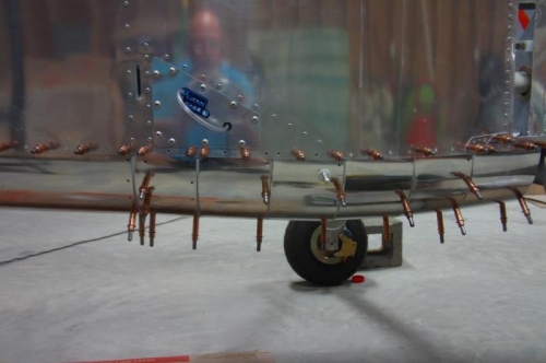

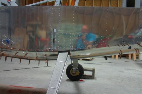

Installed and clecoed LH baggage corner skin, fuselage corner skins, and fuselage corner cover plate. Also reinstalled pilot step floor and clecoed into place. During installation, sprayed all mating surfaces of skins and ribs with corrosion inhibitor (ACF-50).
As part of installing F-1275C-L fuselage corner skin, installed temperature probe and connected wires via spade connectors.
