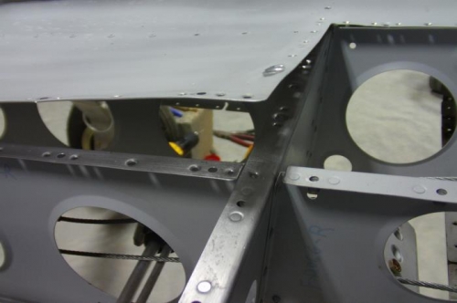

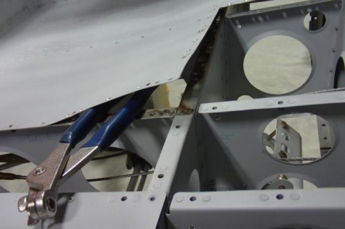

Remove rivets and nutplates from RH baggage floor to access skin/flange rivet line. Also removed fuel tank attach angle on aft bulkhead so baggage floor could be lifted up.

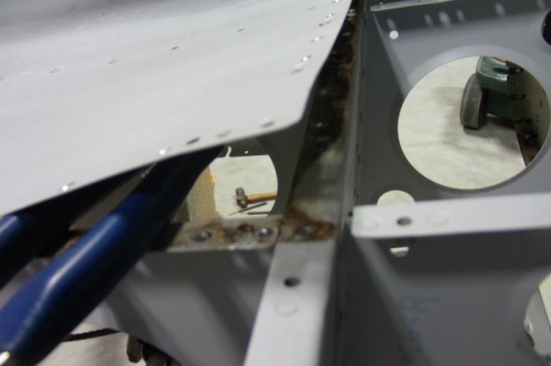

Cleaned the baggage floor skin and upper edge of baggage floor ribs. Cleaning accomplished by rubbing affected areas with rags soaked in Acetone to remove primer. As required, used stiff nylon brush and Acetone to get into corners. Scrubbed corrosion areas with Scotch Brite pad soaked in Acetone (did a real good job removing corrosion). Still need to treat raw aluminum with Alumiprep 33, Alodine 1201, and prime.
Aft Corner of RH Baggage Floor
Closer View
Closer View
Cleaned up
Cleaned up
