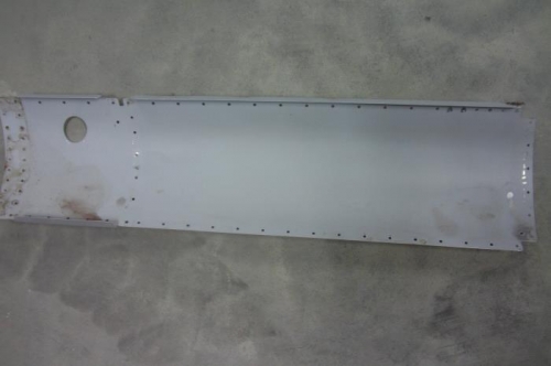

Brief Description:  Removed Baggage Corner Skins
Removed LH and RH flaperon torque tubes from the flaperon torque arms. Also removed nylon grommets from through-hole in each baggage corner skin.

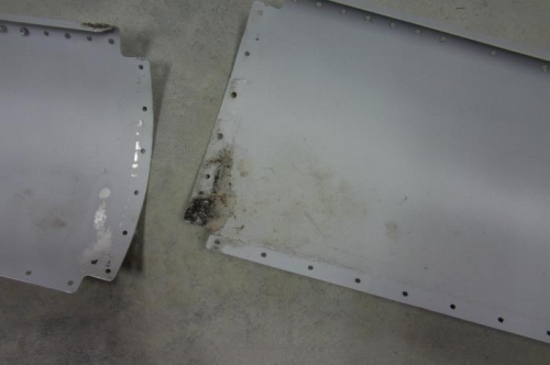

Removed both baggage corner skins to inspect for damage on skins as well as unaccessible areas under the skins. Damage was not too bad on either skin but there were a few areas of concentrated corrosion. Probably could clean that up fairly easily but figured since the skins were already removed and new ones are relatively cheap (about $20 each), might as well just replace with new ones. One more item to add to the order list.
LH Side
LH Side
LH & RH Side
LH & RH Side
