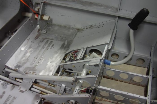

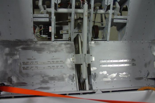

Brief Description:  Cleaned P/CP Seats & Floors
Cleaned the following areas:
- Pilot Seat Pan
- Pilot Arm Rest (removed rivets connecting arm rest to side of fuselage)
- Pilot Foot Panel (previously removed)
- Passenger Seat Pan
- Passenger Arm Rest (no rivets removed)
- Passenger Foot Panel
- Forward Tunnel Cover
- Flap Handle Access Cover
Cleaning accomplished by rubbing affected areas with rags soaked in Acetone to remove primer. As required, used stiff nylon brush and Acetone to get into corners. Scrubbed corrosion areas with Scotch Brite pad soaked in Acetone (did a real good job removing corrosion).
Still need to treat raw aluminum with Alumiprep 33, Alodine 1201, and prime.
Seat Pans Cleaned
Seat Pans Cleaned
