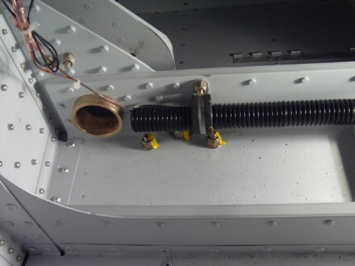

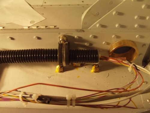

With Michael's help, torqued outboard main gear attach bracket bolts. Used a crowfoot to access nuts. Torqued nuts for the AN5 bolts to 140 inch-pounds but had to modify torque wrench reading to 130 inch-pounds due to 3/4" extension of crowfoot. The calculation is shown below for the record. Reseated bolts and torqued again. Installed HW-00003 plugs.
Torque Wrench Adjustment:
New wrench value = (T x L)/(L + E)
T = 140 inch-pounds (desired torque)
L = 8 inches (length of torque wrench)
E = 0.75 inch (crow foot extension)
New wrench value = (140 x 8)/(8 + 0.75) = 1,120/8.75 = 128 inch-pounds (rounded up to 130)

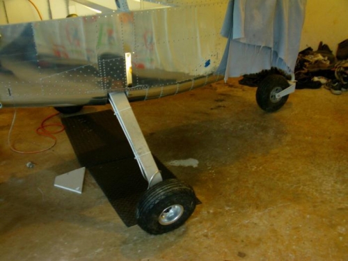

Removed supports from under fuselage.
Step 49
Reinstalled outboard cushion clamps to center section.
LH Side
LH Side
RH Side
RH Side
Back on it's own Legs!
