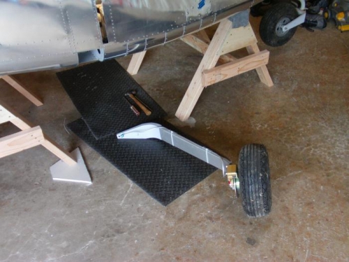

Removed both main landing gear.

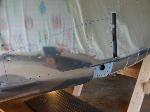

Step 15
Marked fuselage skins and removed rivets. Carefully drilled heads until they popped off, then punched remaining portion of rivets through skin.

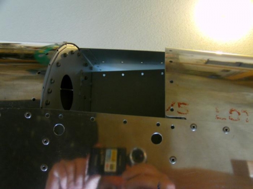

Step 18
Removed rivets and removed F-1204T-L & -R skin stiffeners. Used a 90-degree drill and drilled out rivet heads from above and then punched out remaining portion of rivets.

Main Gear Removed
Main Gear Removed
Fuselage Rivets Drilled Out
Skin Stiffeners Removed
