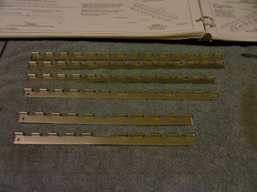

Brief Description:  Trial Fit Seat Assemblies
Trimmed corners of F-1237C-L & -R side seatback angles. Separated F-1237B & D seatback angles and F-1237G seatback braces. Made F-1237H seatback hinges and F-1237F fwd and aft seatback brace hinges. Match drilled F-1237F aft hinges to seatback braces and F-1237H seatback hinges to lower seatback angle. Diasassembled, marked, and deburred parts. (page 26-02, steps 1 through 13).
Page 26-02 is complete.

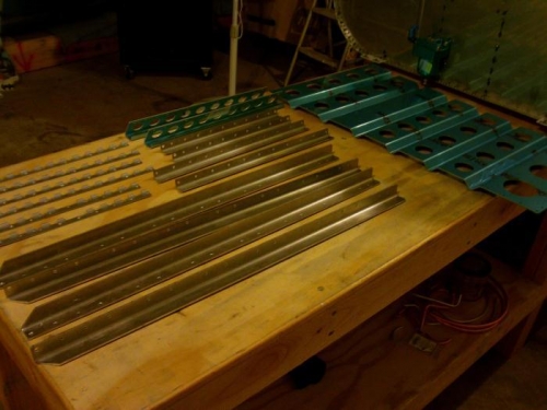

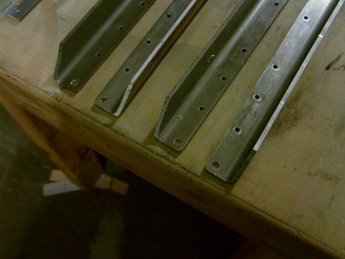

Clecoed F-1237F fwd seatback brace hinges to seatbacks and match drilled. Diasassembled, marked, and deburred parts. Clecoed F-1237B upper seatback angles, F-1237D lower seatback angles, and F-1237C-L & -R side seatback angles to seatbacks. Match drilled #12 at bottom outer corner holes in both seats. Diasassembled, marked, and deburred parts. (page 26-03, steps 1, 2, and 4).
Hinges Ready to Match Drill
