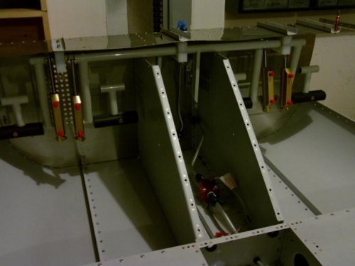

Brief Description:  Built Rudder Pedal Assembly
Greased brake pedal torque tubes and installed into rudder pedals, then secured with pedal blocks and specified hardware. Attached master brake cylinders to the rudder pedals and torque tubes (page 27-03, steps 5 through 7).
Set rudder pedal assembly into installed position to check alignment.
