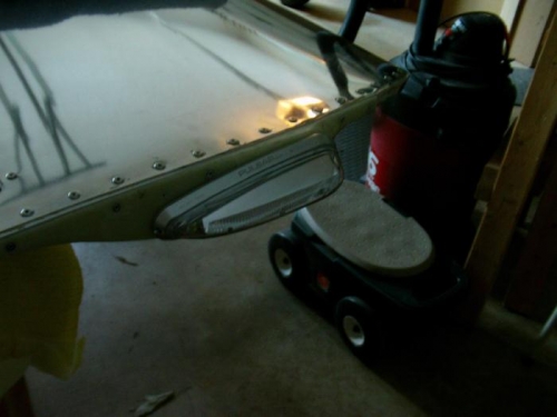

Re-installed landing light and lens (refer to page 40-09, steps 7, 8, and 9).

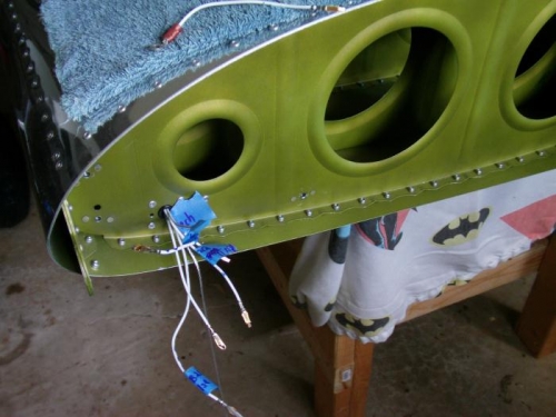

Stripped wires at inboard end and crimped on ES-00079 floating connector pins. Also, did ground wire. Something told me to verify the fuselage pin outs were correct. Ran into conflicting information for the landing light pulse wire between Section 31A, Section 31B, and the wiring diagram (for finishing kits after 8-25-11). Here’s what I found:

Attached pin on two new wires at wing tip and inserted into RH wing extension connector. Re-wired RH wing light connector by separating Nav/Strobe pin into separate pins and inserted separate nav power pin, strobe power pin, and strobe synch pin into connector. Secured wires with tie wrap. Marked connector and connected both ends together. (page 31A-06, steps 1 through 11 - RH side).

Using a power supply, verified that landing light steady, landing light pulse, nav (green), and strobe lights worked correctly.
