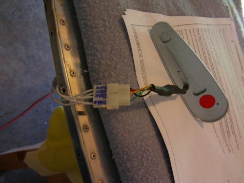

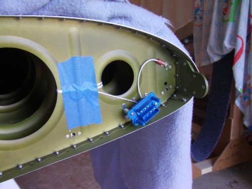

Attached all wires at LH wing root to ES-00078 connector. (page 31A-04, step 9).
Attached ground wire from wing connector to wing rib. Secured LH wing connector to standoffs. (page 31A-05, steps 1 and 2).

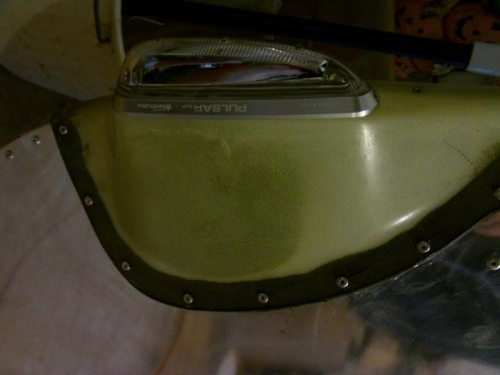

Attached pin on two new wires at wing tip and inserted into LH wing extension connector. Re-wired LH wing light connector by separating Nav/Strobe pin into separate pins and inserted separate nav power pin, strobe power pin, and strobe synch pin into connector. Secured wires with tie wrap. Marked connector and connected both ends together. (page 31A-06, steps 1 through 11 - LH side).
Repeated page 40-09, steps 1 through 7 and re-installed LH wing tip extension, including fuel tank sealant.
LH Wing Connector
LH Wing Connector

LH Wing Extension Re-Installed
