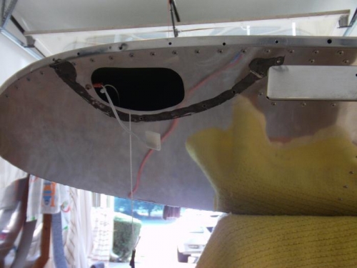

I have been avoiding this section knowing that I didn't think things through when I installed the string through the wing in Section 16. The outboard end of the string was taped to the outboard wing rib and I wasn't sure that I would be able to access it through the small oval hole in the wing tip extension. Unfortunately I was right. Bit the bullet and removed the wing tip extension. It took some time to break the extension loose from the sealant but eventually prevailed without damaging anything.

Fabricated both strobe power wires and both strobe synch wires. With Michael's help and string, pulled strobe power wire and strobe sych wire through the LH wing. (page 31A-04, steps 4 and 5; also step 8 - LH wing).
Wing Tip Extension Removed
