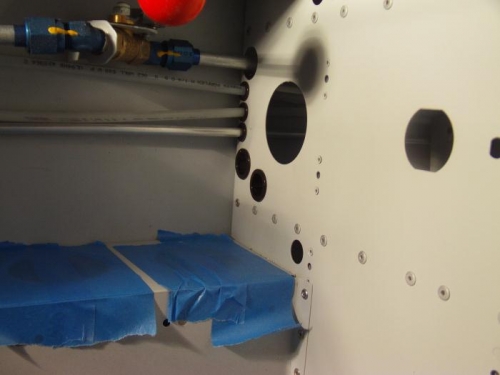

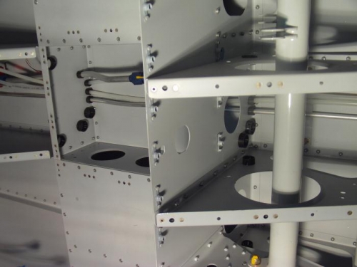

Drilled additional 3/4" hole in F-1203A and F-1202F bulkheads. Steps provided measurements on where to drill holes but noticed that there was already a #30 pilot hole in the correct spot for each bulkhead. Used step drill to size holes to 3/4" and installed SB750-10 snap bushings. (page 42D-14, steps 1 and 2).
Page 42D-14 is complete.
