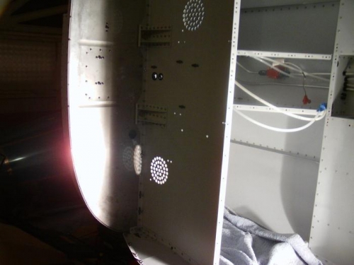

Drilled out rivets and removed F-1202K-L & -R instrument stack supports and F-1202J-L & -R instrument stack angles. Final drilled holes #27 in center of panel base and drilled holes for nutplates. Dimpled and installed nutplates. (page 42D-03, steps 1, 2, and 4 through 7. Step 3 is NA).

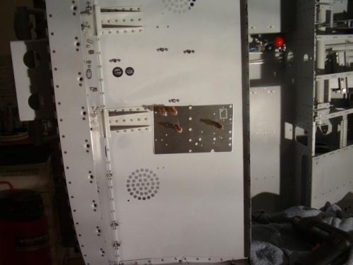

Clecoed F-00011 SkyView template to panel base and match drilled two holes. Final drilled holes to #19. (page 42D-04, steps 1 through 4).

Nutplates Installed on Panel Base
SkyView Template Installed
Holes Final Drilled #19
