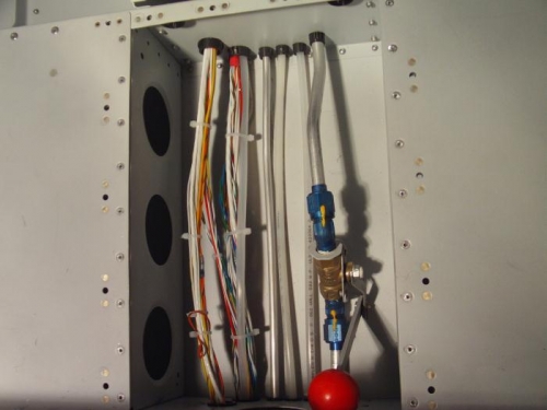

Installed system blocks. (page 31B-23, step 2).
Page 31B-23 is complete.

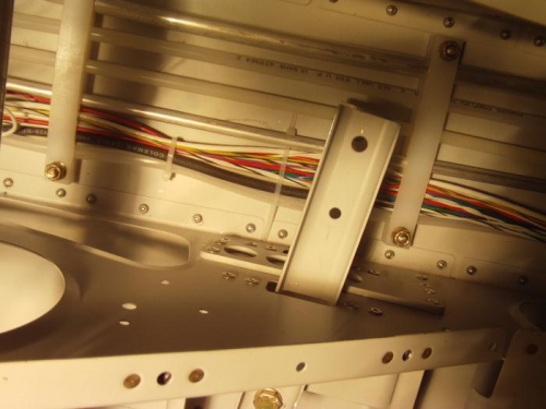

Tie wrapped wiring harnesses throughout the fuselage. Noticed that flaperon mixer arm was rubbing on the wires directly underneath. Found a cool tie wrap technique from another builder, adopted it for my instalation, and pulled the wires down tight against the bottom skin and clearing the mixer arm. Took a full tie wrap and inserted through the rib relief cutout (from left to right), routed tie wrap over the wires, and under the fuel return tube. Cut off the head of another tie wrap and installed on the end of the full tie wrap and tightened against the fuel return tube. Worked like a champ! (page 31B-25, step 5).
Page 31B-25 is complete.
