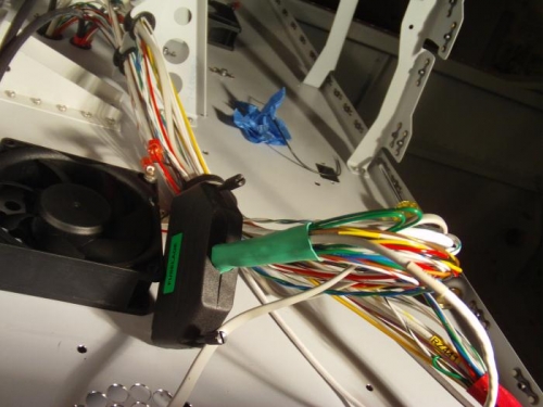

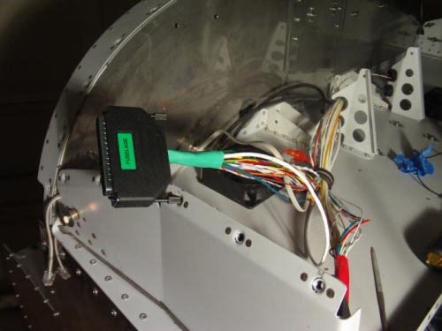

Routed trim wires in tailcone forward and then up through panel base. Continued to route through com support and cushion clamp near left fan and then to fuselage connector. Connected trim actuator and identified "Tab Up" wire at connector by applying +12 vdc and verified that actuator retracted. Inserted 5 wires through heat shrink and installed pins into connector. Once again, needed Denise to help make sure colors of wires were correctly verified before inserting pins into connector. Activated heat shrink and install D-Sub connector. (page 31B-04, steps 1 through 4).
Page 31B-04 is complete.
D-Sub Connector Installed
Backside of D-Sub Connector
