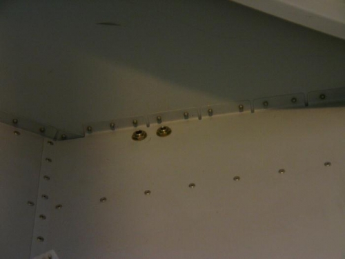

Started the day with intentions of installing the LH headset jack module. The first thing that was noticed was that the aft hole in the seat pan was smaller than the forward hole. There was no way that the step in the isolating washer was going to go through the hole. So, sanded down the shoulder to the point that essentially had a flat isolating washer. Installed both jacks (shouldered isolating washer on the front jack) and then checked for continuity between the nut and airframe. Now I know why they call it an isolating washer - had continuity on the aft jack with the smaller hole. Obviously the jack was making contact with the seat pan. There was not enough room using a regular drill to enlarge the hole so ended up buying a close quarters drill from Harbor Freight. Enlarged the aft hole (both sides of the aircraft) to 1/2" and then reinstalled the jacks with shouldered isolating washers and checked for continuity. No continuity which is good but now I'm one isolating washer short for the other side. Still waiting for auxiliary audio jack parts but will need to find another isolating washer before installing the RH side jacks. No part number that I can find. Finally, drilled the 1/4" hole on RH side for the auxiliary audio jack. (page 31B-17, steps 2 through 5 - LH side only, and step 6).

LH Side Jacks
LH Side Jacks
