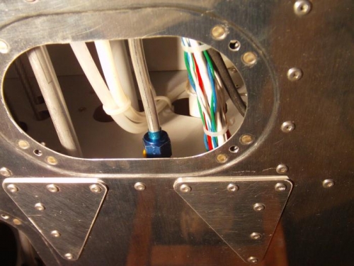

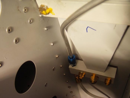

Brief Description:  Installed Main Gear Brake Lines
Still waiting for Aeroshell #22 grease so installed main gear wheel and tire assemblies with dry bearings so brake lines could be fabricated and connected.

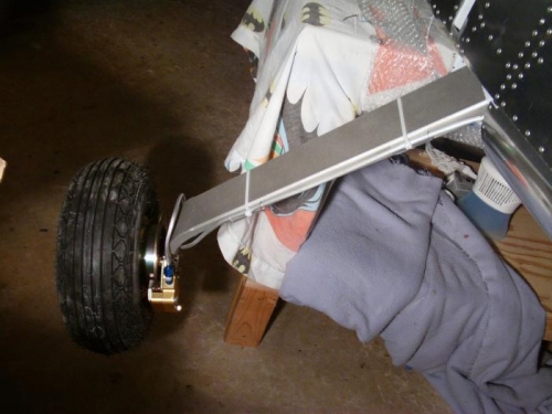

Fabricated LH and RH caliper brake lines. Connected flexible main brake lines to fittings in inboard main gear attach brackets. Not sure why thread sealant is required on AN fittings of caliper brake lines but complied by using Loctite 567 and moved on. Hand bent LH caliper brake line, connected to fitting in inboard main gear attach bracket, routed down aft side of gear leg, hand bent loop around gear leg, and connected to fitting in brake caliper. Verified that brake line is not touching anywhere to prevent chaffing. Repeated for RH side. (page 35-04, steps 3, 4, and 5).
Ensured flexible main brake lines were routed between control rods and above control rods and control cables. With Denise's help, secured flexible brake lines to center section with tie wrap and verified they are clear of control rods. Added a second tie wrap. Slitted clear plastic tubing, installed over caliper brake lines, and secured with tie wraps. (page 35-05, steps 1 and 2).
Brakes Lines at Inbd Attach Bracket

Flexible Brake Lines Secured
