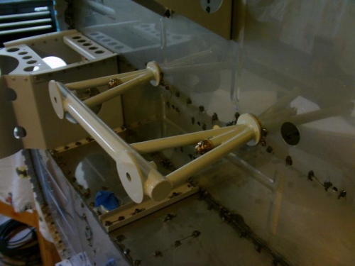

Torqued Engine Mount Standoff
Torqued engine mount standoff AN6 bolts to 13.5 ft-lbs (162 in-lbs). Castellations in AN310-4 nuts aligned with holes in bolts. Nut secured with cotter pins. (page 35-02, step 2).
Standoff Torqued & Safetied
