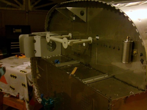

Drilled 3/8" hole in firewall and upper engine mounts and deburred. Installed engine mount standoff and installed bolts. Bolts lined up without having to file edges. Installed washers and castellated nuts but did not tighten - didn't have a torque wrench big enough to torque to proper value. Need to take a trip tomorrow to the aviation section of Harbor Freight to buy another torque wrench. (page 35-02, step 1 and part of step 2).
Engine Mount Standoff
