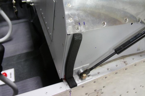

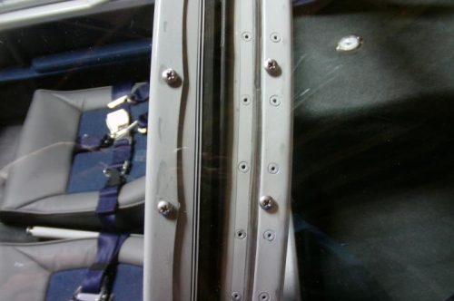

Deburred seal retainer and beveled slots. Scuffed seal retainers with Scotch Brite pads, cleaned with Acetone, and primed with Stewart Systems primer. Installed applicable stuff inside cockpit, then loosened nuts securing the canopy to the canopy frame. Installed seal retainers and loosely tighten nuts. (steps 1 through 3)
Installed roll bar seal into seal retainer and cut off excess. Closed canopy and had Denise on the outside to direct seal movement forward or aft to compress seal to approximately 1/16". Already primed seal retainers (no need to mark), so tightened screws and nuts. (steps 4 through 8)

Trimmed top end of each vertical seal at an angle. step 4)
Closed canopy and noticed that the inside edge of canopy frame sits tight against the vertical seal but does not compress it as the instructions say, so no need to cut a horizontal slit. (step 5)
