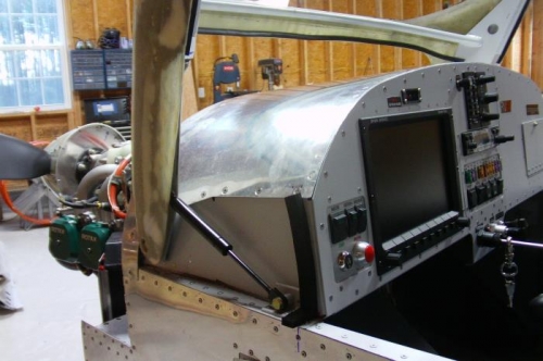

Brief Description:  Install Canopy Front & Side Seals
Page 34-17
Fabricated base seals, temporarily positioned on panel base, and added reference marks on fuselage side skins. (steps 4 through 8)
PAGE 34-17 IS COMPLETE

Cleaned panel base with alcohol, applied red RTV at canopy rib intersection, and installed previously fabricated base seals. Plans called for clear silicone sealant but used red RTV since that's what I had. (steps 1 through 4)
Temporarily held canopy rib vertical seals in position, pushed at edge of upper forward fuselage skin to mark height, then cut 1/4" longer than mark. (step 5)
PAGE 34-21 IS COMPLETE

Using canopy rib vertical seals as is (not using alternative 3M 1099 adhesive - rest of step 1 is NA). Applied red RTV at lower end of base seals and peeled backing from vertical seals. (step 1)
Attached vertical seal, following reference mark curvature. Waiting for sealant to cure. (steps 2 and 3)
