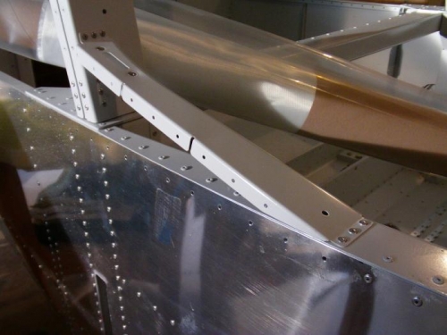

Brief Description:  Installed New F-1254-R Support Frame
Reinstalled new F-1254-R support frame. Installed turtle deck skin and still had a bit of interference with canopy skirt but it was less than with damaged support frame. Noticed that F-1234-R canopy deck was overlapping side skin causing the turtle deck skin to pivot away from the support frame when clecoed. Trimmed canopy deck to be parallel to the side skin and everything fit much better.
New Support Frame Installed
