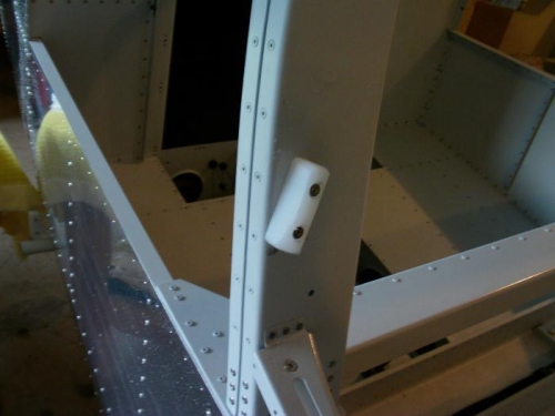

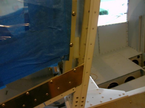

Brief Description:  Installed Guide Blocks
Fabricated guide blocks. Located and drilled holes in roll bar, then tapped. Secured guide blocks to roll bar with screws. Had plenty of interference between aft nut and lower outer edge of both guide blocks. Aggressively trimmed lower outer edges of guide blocks until canopy rotated open and closed without interference. Denise helped by holding canopy open while trimming guide blocks. (page 34-12, steps 1 through 6).
Page 34-12 is complete.
LH Guide Block
LH Guide Block
RH Guide Block
RH Guide Block
LH Guide Block - Canopy Closed
