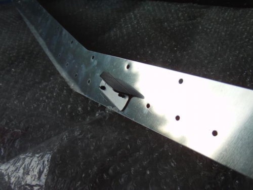

Aligned guide plates in slot in the guide block and positioned against the canopy frame. Match drilled guide plates to canopy frame. (page 34-08, partial step 3).
Aligned and clecoed canopy lift handles to canopy skirts, then match drilled second hole in lift handles using hole in skirt as a guide. (page 34-09, step 1).
Lift Handle Drilled to Skirt
