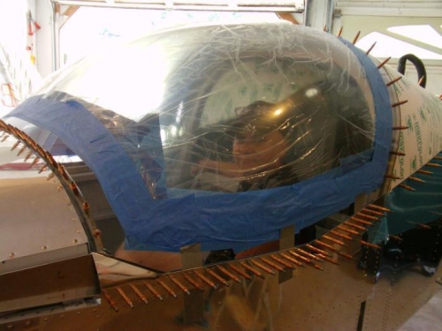

Did final trimming of canopy lower sides as previously marked. Also trimmed aft left side of canopy to clear rear window edge. Finally, trimmed a bit around the front right corner as well as weld at right side of front bow. Machine countersunk five forward most holes in canopy frame. Removed clamps, spacers, and cardboard spacers. (page 34-06, step 6)
Page 34-06 is complete

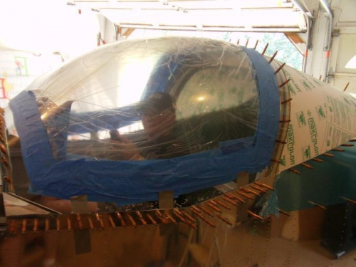

Denise was a trooper and agreed to take one for the team and get clecoed inside. Match drilled holes at each skirt, into canopy, and through attach angles. Removed canopy and set Denise free! (page 34-07, steps 1, 2, and part of 3).
Ready to Match Drill Sides
