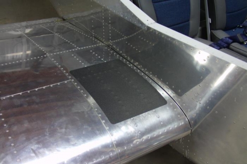

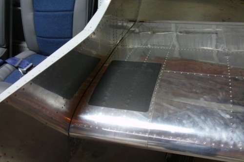

Install Anti-Slip Wing Walk
Cleaned top of wing with Acetone, then with a clean rag and alcohol. Applied both anti-slip wing walks and worked out air bubbles. (step 5)
LH Wing Walk
RH Wing Walk
