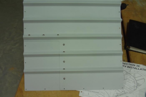

Built Split Baggage Bulkhead Cover
Followed instructions provided with split baggage bulkhead panel (page 33-03, Rev 1 dated 11/17/15)
Aligned both panels and match drilled holes into lower panel. (step 8)
Using nutplates as templates, drilled nutplate rivet holes. (step 8A)
Dimpled all nutplate rivet holes. Also, dimpled rivet holes in nutplates. (step 9)
There is no step 10 on the instruction sheet.
Aligned upper and lower baggage bulkhead panels and secured with screws. (step 11)
SPLIT BAGGAGE BULKHEAD PANEL ASSEMBLY COMPLETE
