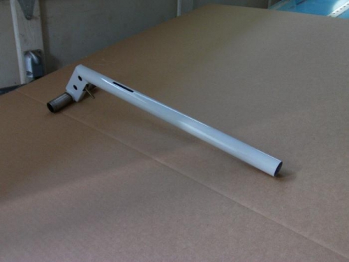

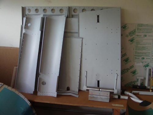

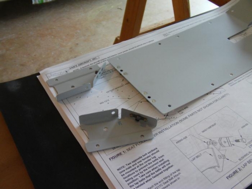

Finally had a decent day to prime and had time to do so. Cleaned all scuffed parts with Acetone and primed. Also, applied clear Krylon paint to fuselage pins and flap handle to provide durability. After primer dried, riveted nutplates to F-1228 seat floor cover and F-1217B-L & -R rudder pedal access covers (page 33-02, step 1 and page 33-03, step 4).
Primed Parts
Primed Parts
Flap Handle Primed & Painted
Nutplates Riveted in Place
