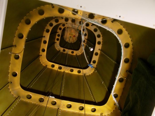

Brief Description:  Installed Rudder Cables

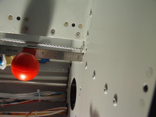

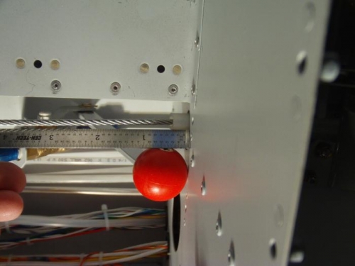

Loosened clamps around rudder cable plastic sleeves and moved sleeves forward until protruding forward of F-1203A bulkhead by 3/8". Tightened and torqued clamp nuts. Drilled #40 holes in aft sleeves and safety wired sleeves to cable forks. Pulled rudder cables through tailcone and out aft end of F-1211 bulkhead. Tie wrapped cable ends together to keep them from falling back inside tailcone. Temporarily attached spade ends of rudder cables to rudder pedal horns. (page 32-11, steps 2, 3, 4, 5, and 7).
Plastic Sleeve - Incorrect
Plastic Sleeve - Correct
Rudder Cables
Rudder Cables
