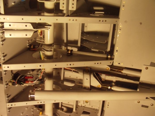

Installed male nylon tee into back of brake reservoir and sealed threads with Loctite 567. Installed brake lines from RH side to nylon tee. Routed brake lines behind wire harness and clamped to bottom of firewall. (page 32-02, steps 2 and 3).
Page 32-02 is complete.
Attached control stick pushrods to control sticks and flaperon mixer bellcranks. (page 32-05, steps 6 and 7).
Page 32-05 is complete.

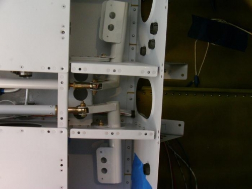

Routed flaperon pushrod assemblies through bulkheads and connected to flaperon mixer bellcranks. Installed flaperon torque arms to bearing brackets at baggage bulkhead. Torque arms seemed very loose with a lot of movement around the bearing. Looks like this is normal based on other builder experiences but will verify with Van's. Connected aft end of flaperon pushrod assembies to torque arms. (page 32-06, steps 2 through 5).
Page 32-06 is complete.
