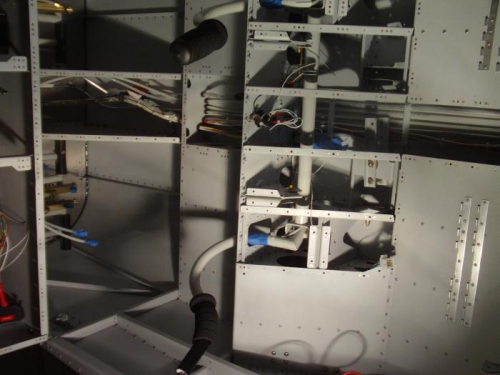

Brief Description:  Installed Control Sticks
Installed control sticks and secured with called out hardware. Installation came out fine but did notice that the RH stick is a little stiff at full RH throw and LH stick is a little stiff at full LH throw. Looks like when the tubes at the bottom of the control stick were filed, they were filed with a slight angle so when sticks are at full throw, the tubes are rubbing on the control column. For now, going to leave it since it's not much and see how it feels when the rest of the flight controls, including autopilot servos, are connected. (page 32-05, step 5).
