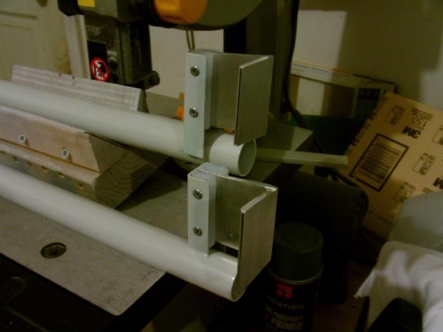

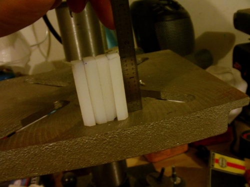

Brief Description:  Installed Spacers in Flaperon Torque Tubes
Cut F-1261 spacers into four individual parts. Clamped spacers to flaperon torque tubes and match drilled #30. Final drilled spacer holes to #12. Scuffed mating surfaces and cleaned with Acetone. Applied epoxy to spacers and installed in flaperon torque tubes. Installed 1/8" angle to maintain 1/8" gap between spacers, then riveted spacers to flaperon torque tubes. (page 32-05, steps 6 through 9).
Spacers Cut
Spacers Cut
Spacers Installed & Riveted
