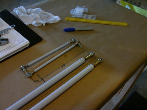

Fabricated F-1264 control stick pushrod assemblies. (page 32-05, step 1).

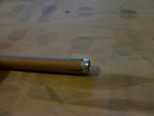

Fabricated F-1265 flaperon pushrod assemblies. (page 32-06, step 1). Used construction paper and a bit of math to create a template to mark equally spaced holes around perimeter of flaperon pushrod ends.

Flaperon Pushrod Template for Holes
Completed Control Rods
