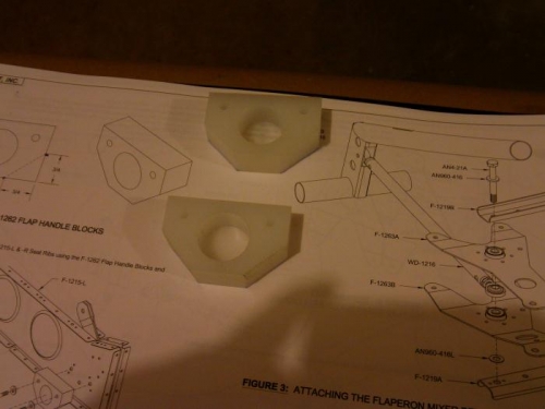

Trimmed corners of flap handle blocks. Cut AT6-058X5/16 tube to two 7 3/4-inch lengths for control stick pushrods and drilled out ends with #3 drill. Still need to tap threads. (page 32-04, step 1 and part of step 4).

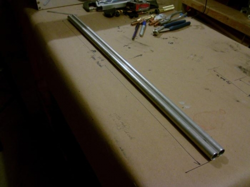

Cut AT6-058X3/4 tube to two 34 5/8-inch lengths for flaperon pushrods. Deburred. (page 32-06, part of step 1).

Flap Handle Blocks Trimmed
Flaperon Pushrods Cut
