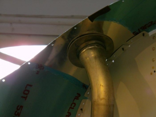

Brief Description:  Fitted Fuel Neck
Using a beveled popsicle stick, removed excess sealant from fuel sight window holes. Drilled #30 holes in T-1204B flange, then assembled T-1211 fuel neck, T-1212 fuel neck collar, and T1204B flange and secured wih clamps (page 37-05, steps 8, 10, and 11).
Page 37-05 is complete.

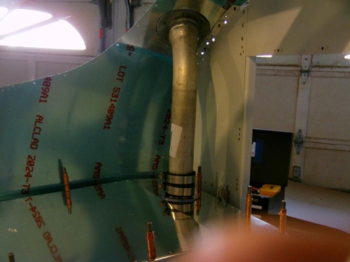

Fitted T-1211 fuel neck against turtle deck skin, then match drilled. To make sure fuel neck was centered in hole in turtle deck skin, temporarily installed fuel cap prior to match drilling. Traced circle around T-1204B flange onto upper tank skin. Disassembled all parts and removed fuel tank from center section. Mactch drill holes from T-1204B flange into upper tank skin and traced inner circle. Removed inner circle from upper tank skin to make opening. (page 37-06, steps 2 through 5).
Initial Fit of Fuel Neck

Final Fit and Match Drill
