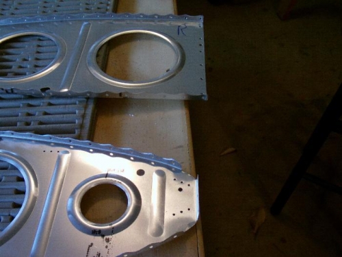

Brief Description:  Trimmed and Started Deburring Nose Ribs
Trimmed left and right nose ribs as specified in steps 2 through 7. Decided to NOT flute ribs yet as called out in step 1 until ribs are completely deburred. Deburred rivet holes in nose ribs but still have a lot of deburring to go.
Separated and deburred W-1216B-L & -R hinge ribs.
Fwd Flanges and Aft Flange Trimmed
Aft Flange Trimmed (Fwd Flanges not Trimmed)
