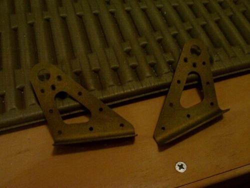

Brief Description:  Prepared New Flaperon Hinge Brackets
Received new left and right flaperon hinge brackets today from Van's. This time I got the countersink the correct depth on both hinge brackets. Deburred all of the edges and holes, lightly scuffed with Scotch Brite pad, cleaned with Acetone, and primed.
New Flaperon Hinge Brackets with Proper Countersunk Holes
