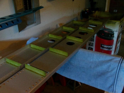

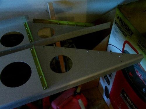

Brief Description:  Riveted Attach Angles to Complete Wing Spars
Attached and riveted all twenty attach angles (with short flanges pointing inboard). Attached and riveted wing tip attach angles. Riveted remaining holes in both wing spars. Used LP4-3 rivets in all holes except for the three most inboard holes on left wing spar where LP4-4 rivets were used per Figure 3.
SECTION 13 WING SPAR ASSEMBLY IS COMPLETE.
Outboard Attach Angles and WIng Tip Attach Angles
Wing Attach Angles
Wing Attach Angles
Remaining Holes Riveted
