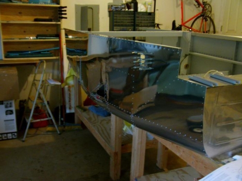

Brief Description:  Completed Fuselage Side Skins
Riveted fuselage side skins to F-1255-L & -R longerons, F-1205A roll bar attach plates, and F-1234-L & -R canopy decks to longerons. Also, installed F-1256 skin stiffeners to aft end of fuselage side skins. (page 23-06, steps 7 and 8).
Page 23-06 is complete.
Final drilled F-1086A and F-1086B vent brackets and F-1096 vent doublers to fuselage side skins, then riveted, Riveted vent doors and installed to make vent door assemblies. (page 23-07, steps 4 through 9).
Page 23-07 is complete.
Match drilled and riveted firewall spacers and lower cowl hinges to firewall bottom (page 23-08, steps 3 and 4).
Page 23-08 is complete
SECTION 23 FUSELAGE SIDE SKINS IS COMPLETE
Left Side Fuselage Skin

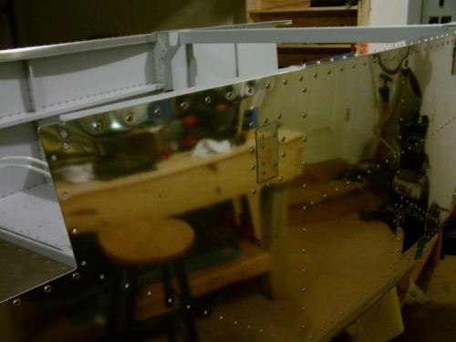

Right Side Fuselage Skin

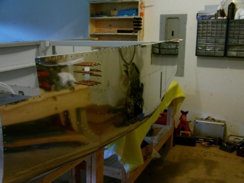

Left Side Vent
Left Side Vent
